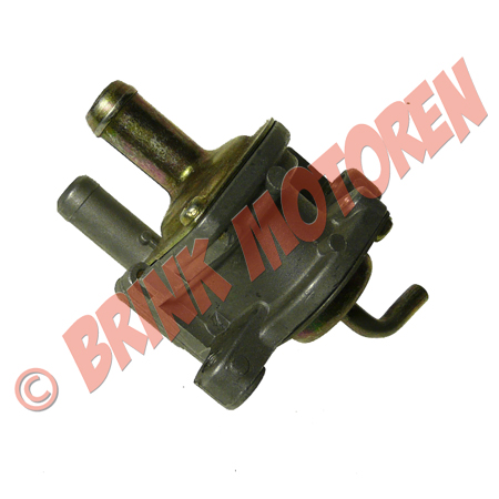

Hello.. First thank you for this forum. I'm Mauro, uit Amsterdam. I am 'rebuilding' a bashan 200s-7.. Altought I have no experience in proper mechanics, only on painting and always doing something with help. The thing is I have the brandstof lucht toevoer with the back (to the inside of frame) slang broken.. I see there is two, one going inside the head of motor, next to the uitlaat and the other one, with the oval golden part broken. Is it to be connected somewhere or just a slang with no connection to suck in the lucht?? Can someone help me alsjeblieft?!

It's just an environmental thing. You can throw it away en plug the connections to the motor and exhaust. It will even run better.
It's a one way valve that lets some extra air in the exhaust.
